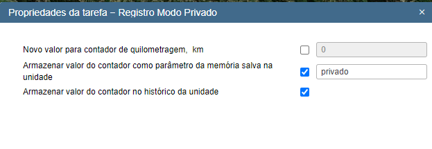

That's what we're using today. The client doesn't need the counter mileage:
01) we created a task to register the counter;
02) created a sensor "Private mode" based on the parameter that has been registered;
03) when the client want to enable the private mode, he change the counter to "1", when he wants to disable, changes to "0".
I think that wialon should allow us to have more flexibility (that we already have) with parameters, for example, creating an action from notifications that register a parameter, or even creating a task of parameter. I don't really know how many different places this could be used, but we could for example, set some intervals of which the vehicles would be in private mode easily with this function, with the task/action of notification + sensor.
