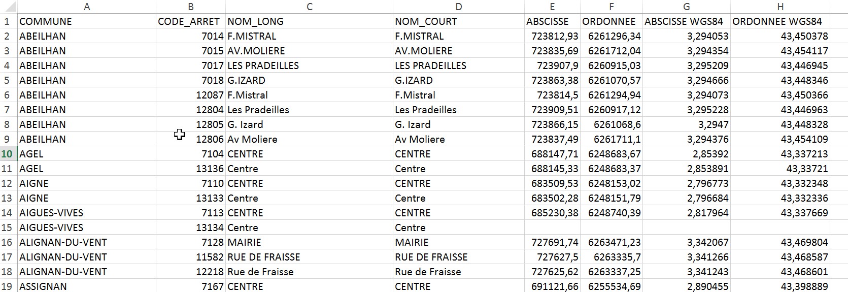

We just signed an important deal with school bus and the client gave me an excel file with long-lat, adresses etc of all bus stop.
I began to enter the points one by one with the adress tool, but it will take a long long time to insert all of them.
Actually, I wonder if there is a possibility to import directly this Excel file (even if I need to change probably the format of column) into Wialon to create POI or Geofences ? I have tried with the Google import KLM but seems a bit complicated.
You can take a look to the screenshot of the file (ok datas are in French sorry wink )
OK you guys, if you have any idea or advice to import the file, please, feel free to help me  smile

Did you try http://www.mapsdata.co.uk/online-file-converter/ or https://www.earthpoint.us/ExcelToKml.aspx?

You also can send your file to support@gurtam.com (just make sure columns are renamed to English) and our maps dept will see if it's possible to assist you in converting them.
