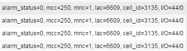

What is responsible for the input of the ignition ?
Photo data from the device attached.

danis Nobody (except you/your installer) knows about which input is connected to ignition circuit wire.
May be this parameter is coded into I/O parameter (I/O=44)
After understanding which input transmits your ignition  I advice you to learn more about "bitwise parameter control".
http://docs.gurtam.com/en/hosting/cms/u … sors/param
