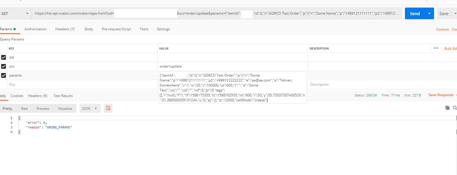

i have attached the postman message i just removed the sid and account id

Your params are ok, everything works.
The issue is with '+' sign in phone number, it must be encoded but Postman skip it in GET method (see screenshot)
Wialon Remote API should be used with POST method (see docs), it solves the issue.
