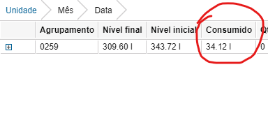

Hello mars, thank you for answering.
I'll try to describe better my ideas.
Problem:
The consumed volume by FLS it's different when consider by Engine Hours, Trips and Summary reports. The value that our clients uses are provided by the summary report only, but it doesn't have many metrics as the others.
The value:
As shown in the first screenshots, there is a significant difference happening when you use the values of consumed during the engine hours or trips to summary, probably caused by the imprecision of the FLSs during the vehicle with engine off. The right value theoretically to use was the difference of the inicial and final value of the fuel level + the fueled volume, so it would be possible to have the right average from the fleet. This value already exists and it's on the summary report, but as I said before, the report doesn't provide the metrics of consumed volume with/without movement neither engine hours with/without movement, so that will be possible to calculate the average wiht/without movement.
It's possible to use the engine hours/trips, but the difference of the real total consumed volume will reach many times around 10%.

Yes, that's right, because in summary we can run the report with group of vehicles and can manipulate some collumns in the calculator, but let me try to explain it again in a different way why we need these columns in summary:
We used to monitor fuel in Omnicomm platform, the platform from the trackers and sensors we use. This system can only calculate fuel consumption like the summary report:
Fuel Consumed = Fuel Fueled - Fuel Theft +  (difference between the inicial and final volume)
The way that trips and engine hours calculate the fuel consumed is different and are the only reports that contain columns with engine with/without movement and fuel consumed with/without movement. Without these columns in the report summary we can't calculate some averages like average with movement (km/l and l/h) and average without movement (l/h).
in the screenshot and excel file I'm sending, you can notice the difference of fuel consumed and averages between both platforms: the values we believe that must be used are the ones that is coming from the Omnicomm, because it consider the total volume of the fuel filled in the vehicles and the difference is slightly high.
