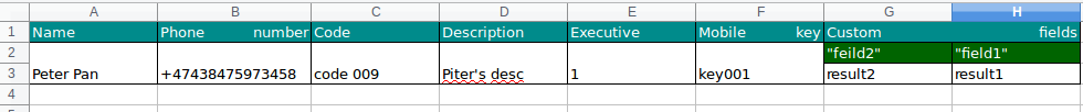

Hello, jhdeguate
I'm sorry for a rather complicated solution, but you'll get the result.
Follоw the steps:
1. Export drivers to .wlp
2. Copy the content of the file
3. Insert it to the converter from .json to .xlsx.
4. Choose the destination (.xlsx), captcha and select rendering "Hierarchy"
5. You'll get some extra rows (e.g. resource ID, position and bound unit ID). Delete them and rename the columns. There is a hint in SDK documentation what parameter corresponds the field.
I've attached an example: driver in the interface, converted table, and final table.
  • Exporting list of: Drivers, Passengers, Trailers and Geofences to .xls

Thanks tata for your help...
This "complicated solution" is A LOT of manual work and as you correctly named: COMPLICATED, and the solution shouldn´t be to hard to do for a "normal/simple human" as ME, please consider to develop the option to get a report with a "click of a button", (remember not all of Wialon´s users are computer´s genius as the G-Team).
